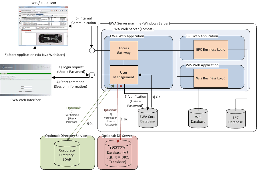

In the following picture a normal workflow for EWA is shown:
Figure: Workflow for EWA
The data flow within EWA is as follows:
Apart from User profiles and User configuration this database is also used to store log entries for error detection (if configured) and user specific access information for billing purposes.
In order to manage User information, a Web user interface is offered. It provides an easy way to add and delete users and licence information in the database. This interface is described in a separate document.

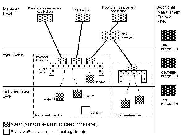

The management interface of EWA is based on the Java Management Extensions (JMX) standard. EWA as application integrates into the existing management frameworks on the given application server. Besides the documented features, the common JMX standards and features also apply on the EWA implementation.
The JMX architecture is built according to a three-level model. This gives flexibility by allowing subsets of the specification to be used individually by different developer communities utilizing Java technology.
Further documentation of the JMX capabilities and limitations can be found on the JMX homepage http://www.oracle.com/technetwork/java/javase/tech/javamanagement-140525.html.

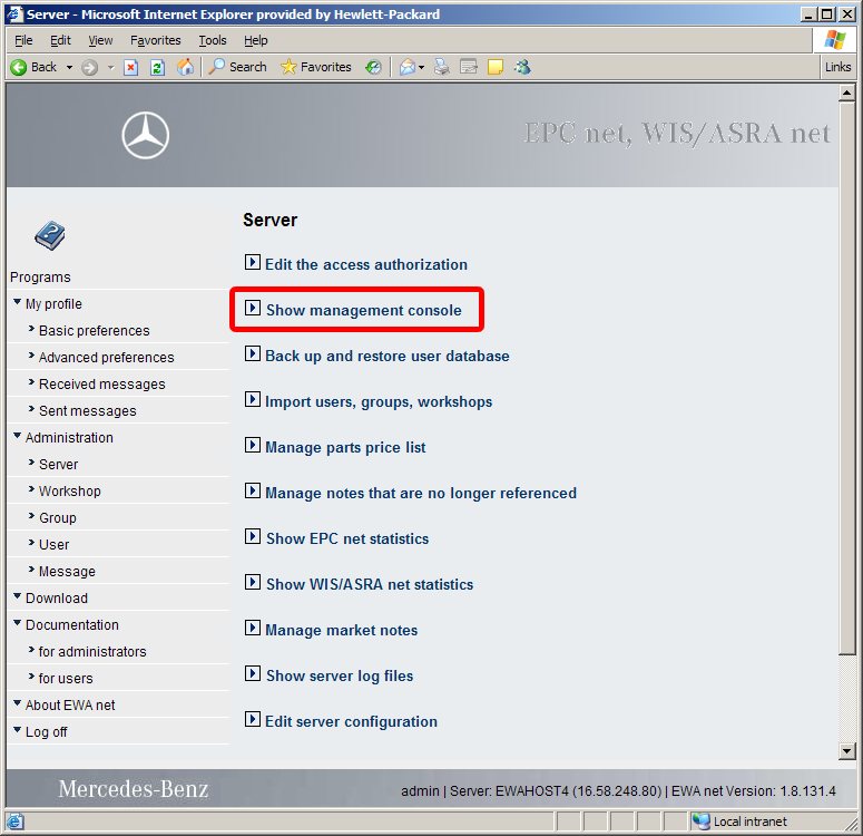

To use the management HTTP interface, log in as administrator on the EWA server and navigate to "Server Management".
Then use the link presented at "Show Management Console" to run the HTTP adapter page.
Note:
 When this link is disabled, please check the configuration.

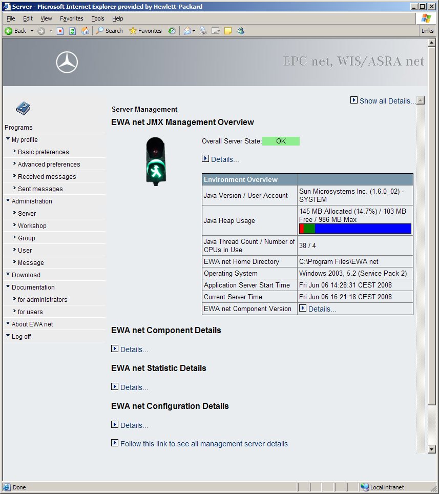

If the page is displayed you will see an overview screen of the server state which allows to drill down to details.

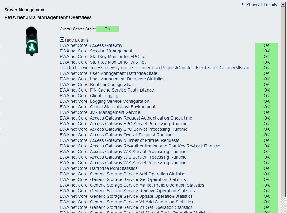

When clicking on the details links, details of components, configuration and statistics will be displayed.
Using the link "Follow this link to see all management server details" will open up the regular JMX console and display all management object details.
The web server will expose all its internal management objects to the EWA management service. All components which are listed beneath "Other Domains" in the overview page are exposed by the web server or the JMX implementation itself.
A detailed description of the possible options of the objects are described on the screen.
For further details, please refer to the documentation of Tomcat.
The EWA core components are exposing with a name beginning with "EWA net Core: ". Several objects are included to view details of the server runtime and monitor the state as well as performance metrics. Some self test beans are available to run tests and verify that business logic is still working correctly.
The EWA management information is separated into State, Statistic and Configuration sections. Please drill down into the management page to figure out which options apply. The statistics section for example provides an overview how long request processing for each application takes as average or how long authentication takes to process. If you experience performance issues you can monitor the statistics numbers.
The State of the EWA core components also provides information about access authorization usage.
