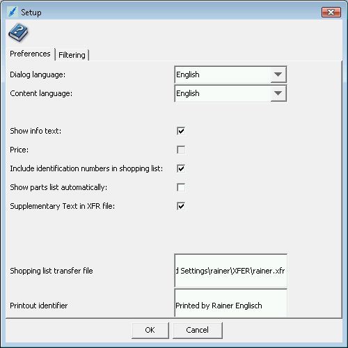

If there is a need that the filename should also be the Windows User Name, than could the variable %EWA_XFR_USER%  replace by the System environment variable %USERNAME%. This would change the path in the example to:
                 c:\Documents and Settings\Jim\XFER\Jim.xfr
This default location can be changed in the user profile via the Utilities configuration.
