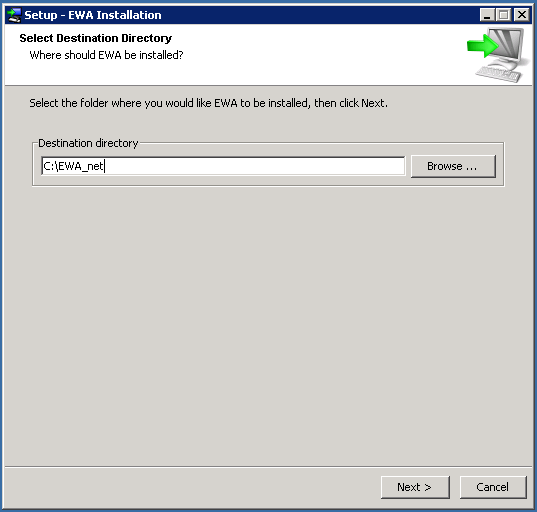

Take your DVD of the EWA DVD release set and execute the setup file from
[DVD-DRIVE]:\ewa\setup.exe
In our example installation our path was set to C:\EWA_net. If you use a different path for your installation, the given command and configuration examples need to be adopted to your folder structure. By default the installer suggests the installation into the Windows standard program files folder - which is perfect for "local" EWA installations.
The installation should finish without any error messages.

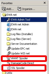

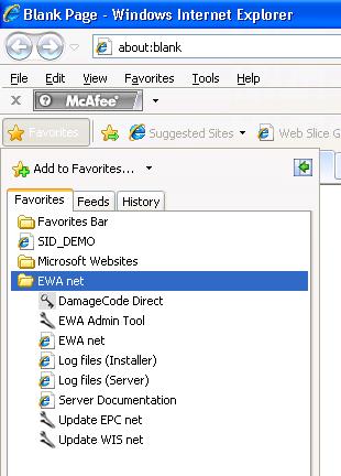

After the installation you will find some new links within the Favorites of your Internet Explorer
With the EWA Admin Tool you should now check the services.
The tab "Server" must display two green traffic lights, the traffic lights in the tabs "EPC" and "WIS" will remain dark until you installed the database content.

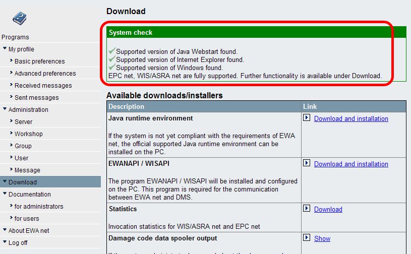

If you want to check whether your clients are well prepared to perfectly run EWA, please assure the following manually steps have been completed as there are no automatic installation steps for the client:

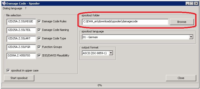

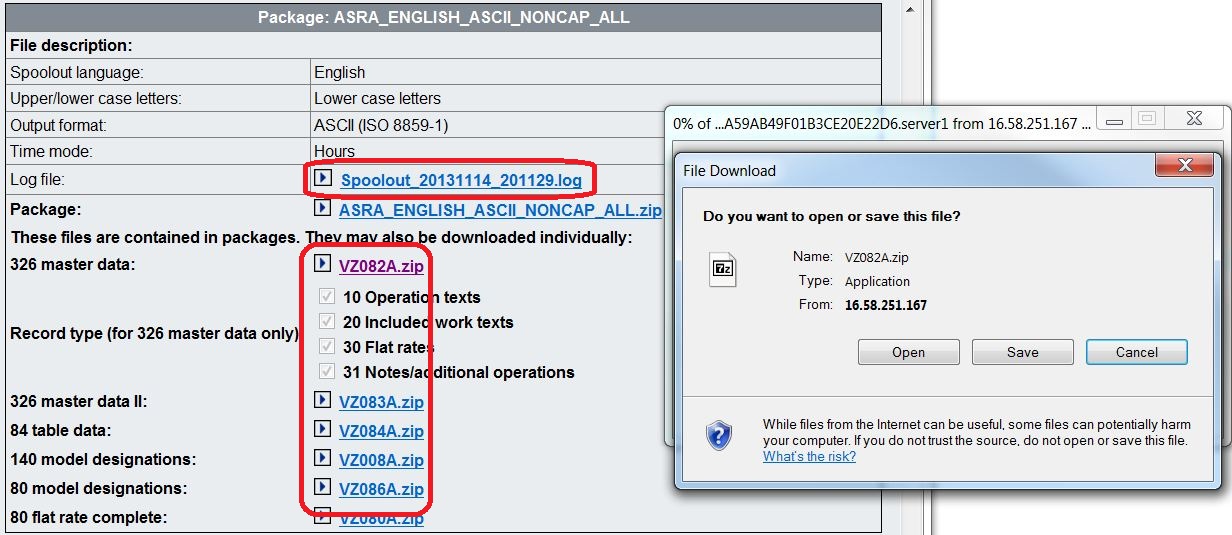

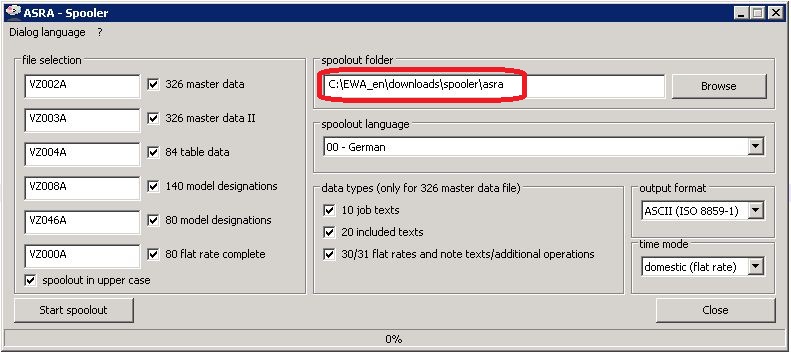

| ASRASpoolout | downloads/spooler/asra | This is the default value where the ASRA spooler files will be expected. Do not touch this setting unless you know what you do. It is the correct default for the interactive spooling. This path is relative to your EWA home directory. You may change this setting to an absolute path somewhere else (i.e. on a network share) if you want to run spooler jobs via "Scheduled Tasks". In this case ensure that all servers in a cluster have the same path information and that your EWA server runs as a service with a user account having access to network locations (the "system" account does not have these privileges) Please find more information about the spoolers here  |
| DamageCodeSpoolout | downloads/spooler/damagecode | This is the default value where the DamageCode spooler files will be expected. Do not touch this setting unless you know what you do. It is the correct default for the interactive spooling. This path is relative to your EWA home directory. You may change this setting to an absolute path somewhere else (i.e. on a network share) if you want to run spooler jobs via "Scheduled Tasks". In this case ensure that all servers in a cluster have the same path information and that your EWA server runs as a service with a user account having access to network locations (the "system" account does not have these privileges) Please find more information about the spoolers here  |

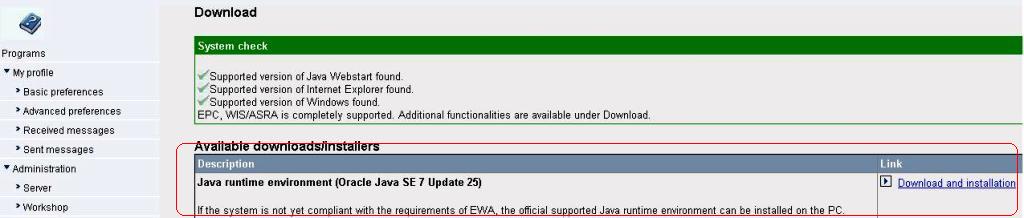

| privateJREVersion | Oracle Java SE 7 Update 25 | The version of Java Runtime that is included in EWA. This is just the version text to be displayed on the EWA download page. |

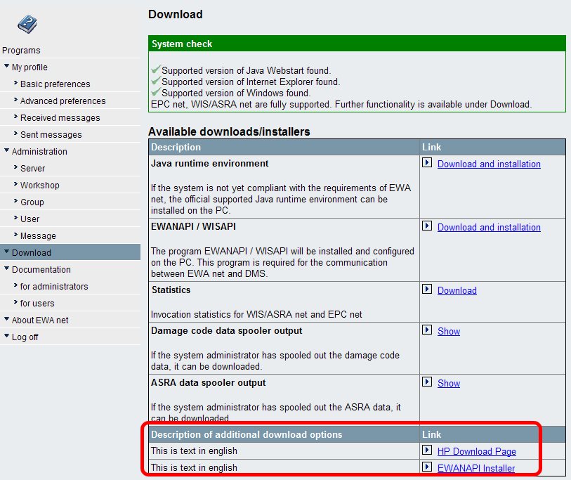

This is an optional file which will neither be installed by the installer nor be updated or modified by any software installation process. Thus if you want to integrate your own download sections within EWA's download section please follow this short description and have a closer look into an example file which will show you how to customize your environment in respect to download options.
The configuration file will be read each time the download page will be shown so you may customize it without the need of restarting the EWA server.
The file must be created and stored within the [EWA_HOME]\config folder with the given name additional_downloads_cfg.xml.
The basic structure of the file is as this:
<?xml version="1.0" encoding="UTF-8" standalone="no"?>
<xml>
        <!-- Section to enter further downloads to the download area -->
        <SECTION name="AdditionalDownloads">
        </SECTION>
</xml>
What we have created up to now is an extension of the downloads section with exactly 0 new entries. So we need to add the subsections which will show up inside the download area. We add an enumeration of sections called "AdditionalDownload_x" where x is a number from 1 to the number of sections you want to add.
Example:
<xml>
        <!-- UserRoleForApplication can take more than one value, the roles should be comma separated -->
        <!-- The valid values for UserRoleForApplication are: ServerAdmin, WorkshopAdmin, WorkshopUser -->
        <!-- The default value for UserRoleForApplication is WorkshopUser, WorkshopAdmin, ServerAdmin -->
                <!-- Start your enumeration with value "_1" and enumerate your keys from there -->
                <SECTION name="AdditionalDownload_1">
                        <!-- Description can be provided multiple times if you want to specify descriptions in different languages -->
                        <!-- But then ensure there is at least one default text without "locale=" specification -->
                        <PARAMETER name="Description" locale="en">This text will show up in anglish <br>if browser requests english</PARAMETER>
                        <PARAMETER name="Description" locale="de">Dieser Text erscheint in Deutsch wenn der Anwender Deutsch als Sprache eingestellt hat</PARAMETER>
                        <PARAMETER name="Description">This is the default text which will show for all other browser languages. We better use English here :)</PARAMETER>
                        <!-- Location to download, absolute path or, by use of URL-Rewriting, a relative EWA Server reference -->
                        <PARAMETER name="URLofDownload">http://www.hp.com</PARAMETER>
                        <PARAMETER name="LinkText" locale="en" >Have a closer look on the HP Page i.e. for Driver Updates</PARAMETER>
                        <PARAMETER name="LinkText" locale="de" >HP Download Seite</PARAMETER>

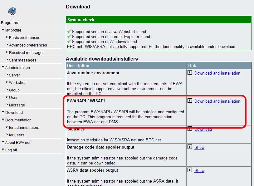

                        <PARAMETER name="LinkText">HP Download Page</PARAMETER>
                        <!-- User Role that has access to this download. If not specified, all users may have access to it -->
                        <PARAMETER name="UserRoleForApplication">WorkshopUser, WorkshopAdmin, ServerAdmin</PARAMETER>
                </SECTION>
                <SECTION name="AdditionalDownload_2">
                        <PARAMETER name="Description">The link for the EWANAPI Installer provided here again</PARAMETER>
                        <PARAMETER name="URLofDownload">/EWA-net/ewanapi_installer.jnlp</PARAMETER>
                        <!-- Shall we include/do we need to include session information in the URL? Default: false -->
                        <PARAMETER name="URLdoRewriting">true</PARAMETER>
                        <PARAMETER name="LinkText">EWANAPI Installer (again)</PARAMETER>
                </SECTION>
                <SECTION name="AdditionalDownload_3">
                        <PARAMETER name="Description">Download and run a setup located at [EWA_HOME]\downloads\test\Setup.exe</PARAMETER>
                        <PARAMETER name="URLofDownload">/EWA-net/download/downloads/test/Setup.exe</PARAMETER>
                        <!-- Shall we include/do we need to include session information in the URL? We MUST use session information to allow access to download below the "downloads" directory-->
                        <PARAMETER name="LinkText">Some sample Setup</PARAMETER>
                </SECTION>
        </SECTION>
</xml>
Following parameter tags can be used:
The example from above will result in a download area extension like this:
EWA is offering you a direct linkout to the Customer Support & Feedback (XSF) application of Daimler in order to deliver your feedback (corrections of documentation, improvements, handling problems etc.) to the proper parts of the After Sales organization. The problem areas generally occurring in the workshop are clearly defined by so called event categories.

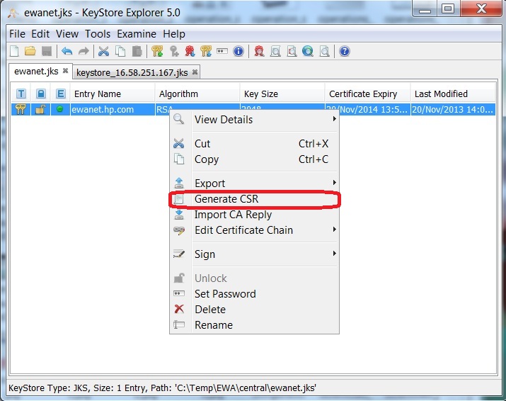

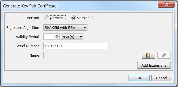

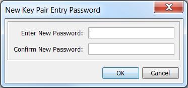

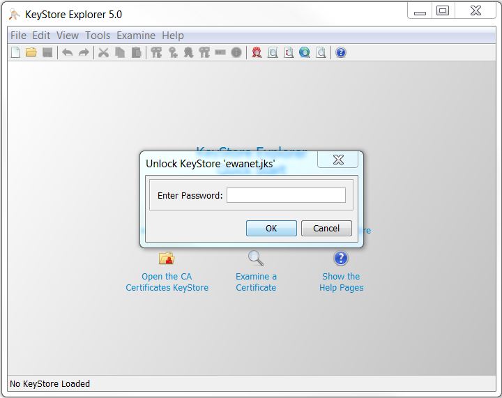

To be able to work with the system you could simply make use of Oracle's "keytool" which is part of a public Java Development Kit. But we recommend to make use of the "KeyStore Explorer" (http://keystore-explorer.sourceforge.net). This document assumes you have this software installed.
Assuming you have installed the "KeyStore Explorer", you will now be able to open the key store at
EWA_HOME\certificates\ewanet.jks
Double-click the file and a GUI will open, asking you for the key store's password.
Note:

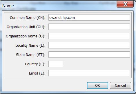

 It is important that for the "Common Name" you specify exactly the server name that your clients of EWA will make use of in the future. Typically it is recommended to use the fully qualified DNS name of the EWA server.
Note:
 DO NOT DELETE THE KEYSTORE NOW. It will be used by the server and you will also need it to re-import the real certificate from a trusted authority like VeriSign. If you delete the keystore and then get your official certificate back, it will be worthless. You will not be able to recreate a keystore and keypair matching this certficate.

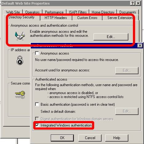

You will typically make use of Windows NTLM authentication if
Note:
Please ensure that you have set up all users with their respective MS Windows domain accounts inside of EWA, i.e. not just "johndoe", but "EMEA\johndoe" in case the user "johndoe" is part of the "EMEA" domain. Forgetting this results in the fact that users cannot automatically be authenticated.
 The passwords of the users inside the EWA system do not have to be "real" passwords. Dummy passwords ensuring that the EWA passwords policy are being matched will be sufficient.
A quick overview over the necessary steps that are required to allow NTLM authentication with Tomcat and IIS:
After setting up Tomcat and IIS you must also perform the steps in the following sections:
The steps will be described in detail below. Don't worry, they are quite quickly and easily performed.

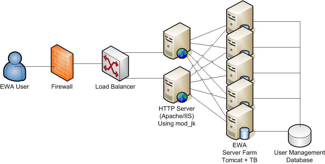

You may setup IIS on the same machine as your EWA installation is running on, or you may install it on a separate machine. For smaller installations that will run in NTLM mode only it might be sufficient to setup the IIS on the same machine as the EWA server is running on.
Note:
For large EWA installations and/or installations that you want to run in mixed mode (users being part of a Windows domain and "other" users who would have to login to EWA interactively) you will definitely have to setup separate instances of Web Servers - one with NTLM security switched on, one with anonymous security to allow interactive login to EWA.

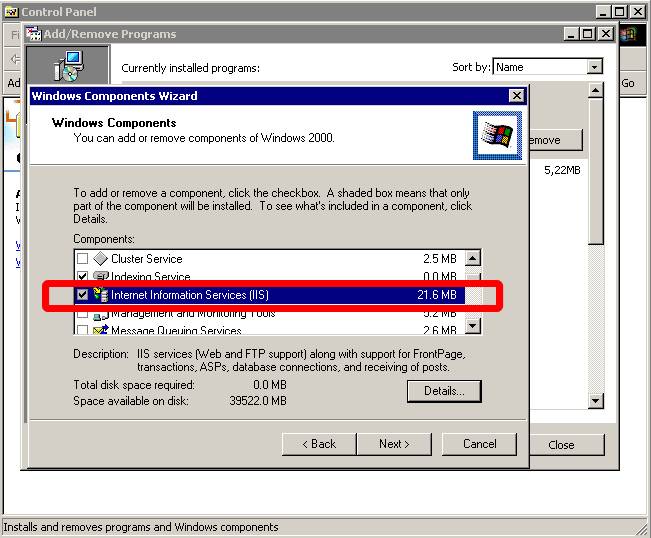

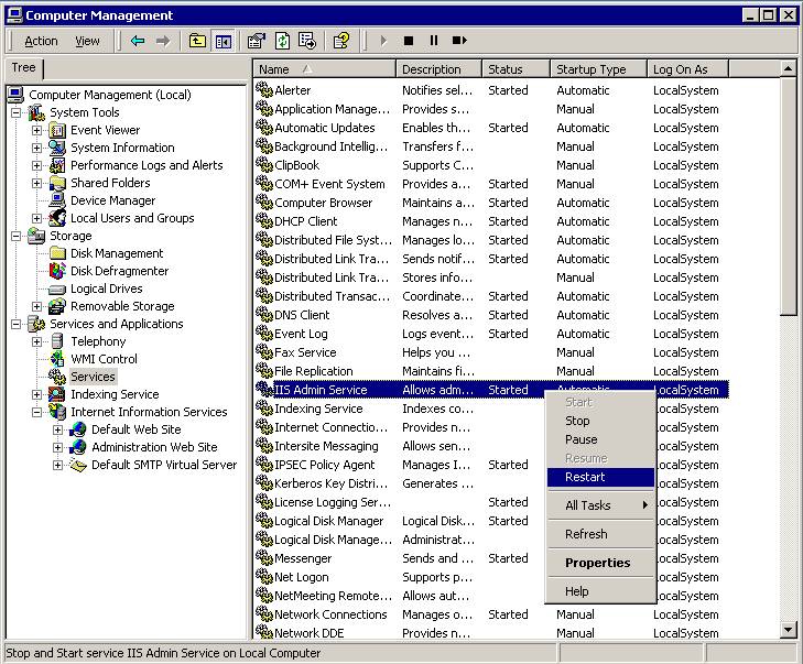

Installation, if not already done, can be performed via the Windows Control Panel in the "Add/Remove Software" control. Choose "Add/Remove Windows Components".
Note:
This description assumes that IIS can be used for the EWA integration only. For hosting of several different applications with this single IIS instance  you may encounter restrictions or problems.

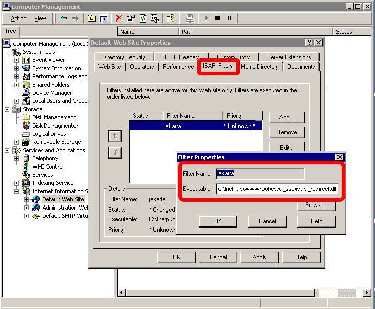

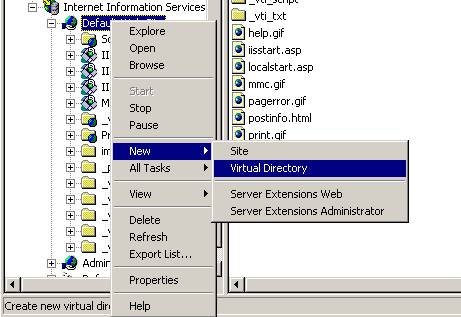

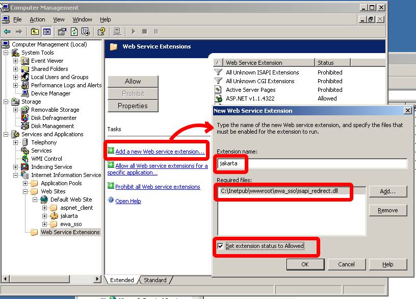

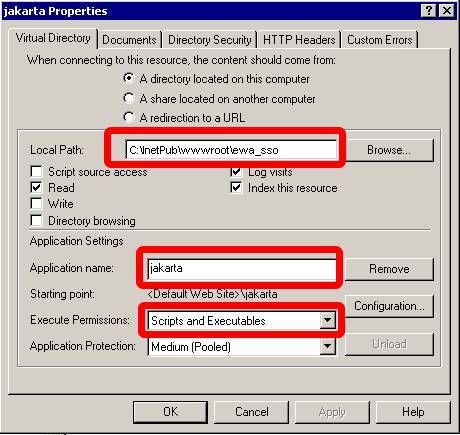

After installing IIS you have a new directory structure below C:\InetPub
In order to allow a Web Server plugin to contact the EWA application server we must enable the module allowing this. Open the file
[EWA_HOME]\server\conf\server.xml
Search for the word "AJP/1.3" which will guide you to the connector for the Web Server plugin. This is by default commented out, so remove the XML comments before and after the "Connector" section.

After you have all files installed you can start configuring the IIS. Open the Windows Management Console and open the hive of the "Internet Information Services".
Add the redirection handler which will forward all EWA related request to the EWA server. Select the "Default Web Site" hive and display its properties. Select the tab "ISAPI Filters" and add a new filter with name "jakarta" and pointing it to the isapi_redirect.dll into this directory:
 file in the installation directory of your SSO files, i.e. C:\InetPub\wwwroot\ewa_sso\isapi_redirect.dll
Press "OK" and select the tab called "Directory Security". Click on "Edit" in the field named "Anonymous access and authentication control". Uncheck any current checkmark and set the checkmark "Integrated windows authentication". Ensure that only this checkmark is set.
Press "OK" to close this dialog and press "OK" again on the properties main dialog. You might be asked whether you want to apply the setting to some other components as well. Simply press "OK" here again and continue.
Now install an additional so called "Virtual Directory". Right-click the "Default Web Site" hive and select "New -> Virtual Directory". This will open a wizard. Please follow the following instructions exactly:
You will be asked for an alias. Please enter "jakarta".
The next screen will ask you for the directory which this virtual directory shall represent. Please enter "C:\InetPub\wwwroot\ewa_sso" or the directory you had chosen above.
The last screen will ask you for the permissions. Ensure you enable the checkmark "Execute (such as ISAPI applications or CGI)".
Finalize the wizard, right click the just created virtual directory "jakarta" and compare your settings with the following screen:
If you run Windows Server 2003 or newer for your Web Server (only in this case) you will have to perform the following additional step which is not needed on Windows 2000 Server based systems:
Click on the "Web Service Extensions" hive and click on "Add a new Web Service extension". If you forget this step the integration will not work as by default unknown ISAPI filters will be forbidden to run. Fill out the appearing dialog as follows:
Okay, that's all for the configuration of the Web Server.
Go to the "Services" hive inside the Management console and restart the "IIS Admin Service" now.
Please review again all your settings.

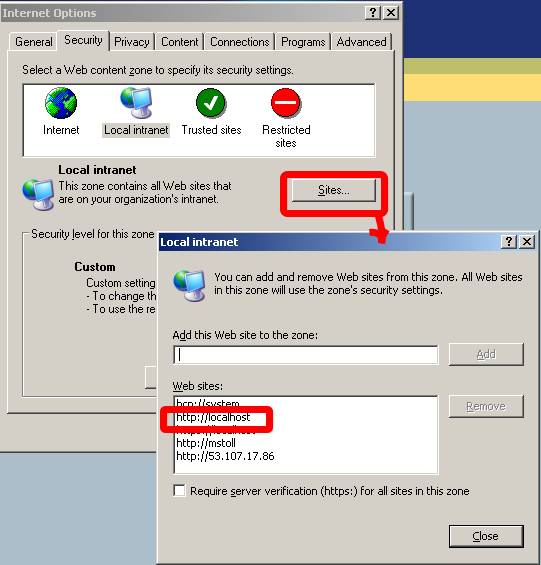

If you perform tests on your Web Server on Windows 2003 directly, please check your Site settings within Internet Explorer to ensure that NTLM credentials will really be sent to the web server. The appropriate settings can be found in "Tools -> Internet Options ->  Security". Please click on "Sites..." and ensure that "http://localhost" is part of that list. See below:
Example:
 Let's assume you have been logged on to Windows as "EMEA\johndoe" where "johndoe" is the account name (user login) and "EMEA" the name of the Windows domain the user belongs to. You may setup a user (no matter which user role) now in EWA with the fully qualified user login "EMEA\johndoe" (pattern <domain>\<userid>) instead of only his login name. This is the most important thing to be aware of. You will have to provide a password for him as EWA , but this will not be used for SSO, of course, but it might be used as a fallback should the domain login not be possible.

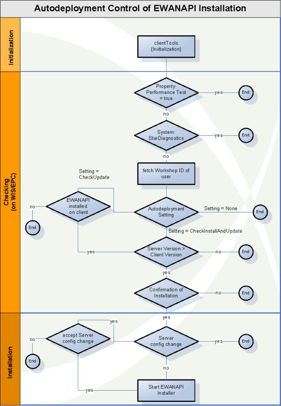

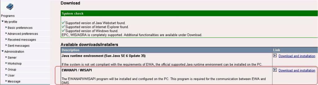

This step will only have to be performed if your installation makes use of the EWANAPI interface (i.e. for DMS interconnectivity,...). In order to ensure that EWANAPI can make use of the SSO feature, it needs the information to which Web Server it has to connect and on which port.
Therefore the users have to login to EWA, run the EWANAPI Installer which will perform the updates.
After the update, you might simply issue a command like this in a command prompt:
EWANAPI.exe
See it? On Windows clients being part of the domain the user credentials will not have to be provided to EWANAPI anymore. The current user credentials of the logged on user will automatically be used. For users not being part of the domain it's still the old game - they will have to provide their credentials on the command line.
 The call above should start the WIS client with the user account of the user who is currently logged on against a domain on that client machine.

EWA local architecture uses Jakarta Tomcat as web server and servlet container. Since EWA's content is mostly dynamic, HP suggests to keep mainly Tomcat as web server for serving content. Additional front-end web servers can be used to distribute request amongst several cluster nodes in the EWA server farm. Besides the request distribution (using a sticky session) the usage of a front-end HTTP server will not generate further performance benefits. The main part for clustering lies in clustering the application servers. HTTP front-end servers could be clustered to improve availability. The EWA installation in this case should be complete and each application server node should contain the application server and the Transbase content databases. The User Management database should be located at a central location and have a high performance clustered server. The clustered architecture of EWA should look like this:
 Example Clustering setup in a EWA Farm
NAT request distributors or Load Balancers can be used for load balancing, fault tolerance, or both. Usually the algorithm chosen to distribute requests depends on the NAT product installed. Most NAT request distributors also offer fault tolerance by detecting various kinds of web server faults, and then will stop distributing requests to any server that is down.
There are many NAT request distributor implementations available, both commercial and as open source software that runs on commodity computer hardware. However further investigation is not part of the scope of this description.
Besides regular NAT request distributor products also built-in Windows Server 2003 functionality for load balancing (NLB) can be used for Distributing requests. Note that Windows Server 2003 NLB is a layer 3 distributor so is not able to detect session types or application server service failures!
When using Apache httpd as web server and Tomcat as servlet container, the communication connector offered by Tomcat (mod_jk) offers best load balancing and failover across several Tomcat instances. Each Apache with mod_jk in a cluster can perform:

IIS Admin Service
World Wide Web Publishing Service
Simple Mail Transport Protocol (SMTP)
Install as many Apache Web servers as the cluster foresees. Usually each HTTP server is installed in a separated server.

[Cluster2] C-JDBC might be useful for the EWA architecture. Testing C-JDBC together with EWA is however not part of the scope in this phase. See http://c-jdbc.objectweb.org.

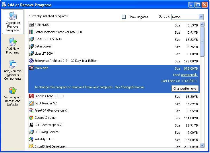

For the de-installation of EWA just follow the standard way for Windows applications. Go into the Control panel into Add or Remove Programs, select the entry EWA and click on Change/Remove.
The EWA software will be completely deinstalled from the system.

EWA provides basically the same spooler programs as provided as part of the former WIS. Those spoolers have slightly been modified to fit better into the EWA architecture.
Note:
This description is not a replacement for the spooler manuals. It just describes installation and basic ideas behind the spoolers in the special context of EWA.
For a reference of the spooler manuals including a description of the file formats please refer to the documentation's table of contents.
Note:
In order to run the spoolers successfully you need at least 2 GB free harddisk space on the disk where the WIS database service is running (!) as complex SQL queries on the database may need temporary space on the disk. Especially the creation of DamageCode rules files need a lot of temporary harddisk space.
In order to be able to create spool files the spooler programs (ASRA spooler and Damagecode spooler) will have to be installed manually from the delivery media of EWA onto the same machine where the EWA installation resides. The installation will be described in more detail in the following sections.
The basic mechanism to spool out data (either via ASRA spooler or Damagecode spooler) and to make it accessible for download in the download area is:
The location for the spool out files can be changed by editing the core configuration file core_cfg.xml within the section "Spooler". By default a relative path is set for both ASRA and Damagecode spooler which is interpreted as relative to the EWA_HOME directory. Server administrators which intend to run the spoolers in batch mode and in a clustered environment may want to change this location to a distinct location which is accessible by all EWA cluster nodes.
Default (relative path)
<SECTION name="Spooler">
    <PARAMETER name="ASRASpoolout">downloads/spooler/asra</PARAMETER>
    <PARAMETER name="DamageCodeSpoolout">downloads/spooler/damagecode</PARAMETER>
</SECTION>
Example (absolute path)
    <PARAMETER name="ASRASpoolout">N:/ewanet_spooler_results/asra</PARAMETER>
    <PARAMETER name="DamageCodeSpoolout">N:/ewanet_spooler_results/asra/damagecode</PARAMETER>
</SECTION>
Note:
It is important for you to know that if you switch your file locations to a network path (accessed via UNC path or via mapped drive letters) you will have to change the account under which your EWA server is running to a user account being allowed to access network resources. The "system" account in Windows is not allowed to do so.
By default EWA gains users with user role "System Administrator" or "Workshop Administrator" access to the download area for spooled files. You can change this behavior to a per-user-setting by changing the value "userBasedDownloadPermissisons" to "true" in the section "General" of the UserManagement configuration file um_cfg.xml. Once done you must explicitly assign the user right "Allow download of spooler files" to any user who should gain access to this download area. Even the system administrator does not have this right by default!

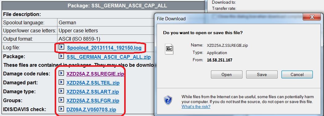

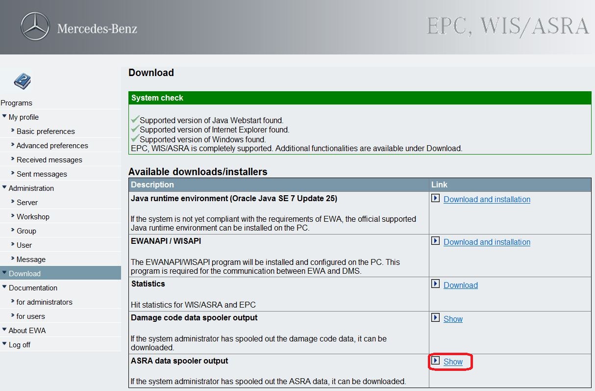

This spooler allows the extraction of ASRA related data from the WIS database in the same way as it was possible with "classic" WIS. After startup of the application you will see the following screen:
The marked text field shows the automatically pre-selected output folder for your files. It is recommended to not change this folder in order to ensure that your spool out files will be written into a location where EWA can find them to allow downloads via the EWA download page.
Note:
Please ensure that you do not accidently override existing files. Please move those files into a backup location before spooling out the files.
After spooling out the data you may login into EWA from any client and display the download section (assuming you have the rights to access those pages).
You may download the files for the ASRA Spooler from the section named "ASRA Spooler Output". You may even browse the log file from here. The download page will list all the file that have been spooled out along with the configuration information that was used to create those files. Clicking on one of the hyperlinks in the browser will make the browser start the download of the appropriate file.

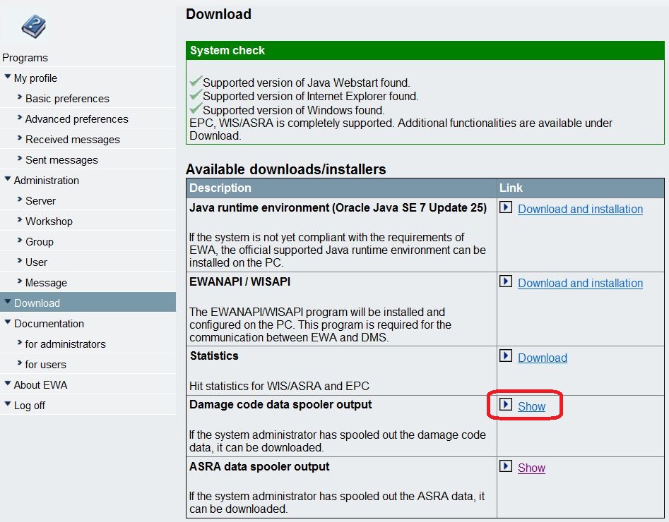

This spooler allows the extraction of damage code related data from the WIS database in the same way as it was possible with "classic" WIS. After startup of the application you will see the following screen:
The marked text field shows the automatically pre-selected output folder for your files. It is recommended to not change the output folder in order to ensure that your spool out files will be written into a location where EWA can find them to allow downloads via the EWA download page.
Note:
You may download the files for the Damage Code Spooler from the section named "Damage Code Spooler Output". You may even browse the log files from here.
If you want to make use of more advanced features like
you will want to make use of the option to run the spooler executables in "batch mode" which means that they do not show any user interface but get their configuration information from a separate ini-file which basically tells them what they have to do. Once you are sure that your created configuration files are valid and operating the way you expect them you can easily make this process part of the Windows Scheduler.
For additional information about using the ASRA and Damagecode Spoolers as well as detailed information about the spoolout files and structure please have a look at the different spooler documents in the documentation's table of contents.
Before users can start working with the EWA clients (EWANAPI installer, EPC , WIS ), you should ensure that the client systems are well prepared. If you have an officially supported Java Runtime already installed on all the client machines, you are well prepared. Going to the Download Area of the User Management in your browser you will notice that the Web Application automatically tries to determine whether your clients are capable of executing EWA .
If you need to install a Java Runtime Environment, you can make use of the one provided in the downloads section. Simply click on "Download and Install" which will download the appropriate Java Installer.
Note:
 After successful installation of a new Java Runtime Environment you may have to log off and on again to update the System check display as it cashes the settings per session to avoid nasty dialogs.
EWA provides an external application called EWANAPI.exe which allows external programs to communicate with the AccessGateway, the WIS client and/or the EPC client.
This application was implemented with downwards compatibility in mind. Its command line arguments are compatible with the classic WISAPI.exe from the former WIS environment. It has been extended to support authentication at the AccessGateway and Shoppinglist calls to EPC .
Note:
To indicate the downwards compatibility there is still a clone of the EWANAPI.exe called WISAPI.exe around that can be used in the same way as EWANAPI.exe
Note:
EWANAPI has matured from a simple DMS integration layer to an API which is heavily used by the Xentry applications like Xentry TIPS or Xentry Diagnostics. Therefore it is recommended to have EWANAPI installed in always the most current version on the client PCs. A so called "automatic deployment" supports to keep the clients up to date. Read more about this feature here.
EWA provides a Java based installer which performs the necessary steps on each of the clients computers that otherwise would have to be executed manually.
The EWANAPI installer can easily be accessed from the Download section of EWA . Simply click on the Download and Installation button. You can also do this anytime you want to update your EWANAPI environment.
Note:
 This step can only be performed once a correct version of Java has been installed on the client. If no Java has yet been installed, just install it via the appropriate Download and Installation button just above the "EWANAPI/WISAPI" installer link.
The installer will always fetch the most recent EWANAPI installation files from the server installation directory [EWA-HOME]\clientapps\EWANAPI. The following files will be transferred to the clients by the installer:

EWA supports a feature called "AutoDeployment". This feature has been introduced with early Xentry releases as Xentry highly relies on EWANAPI as an integration layer.
The idea of automatic deployment is, that an EWA user will not have to take care about a renewal of an EWANAPI release on his client. In former times of EWA , deployment was implemented via a kind of a pull-mechanism, i.e. the user had to check for a new release on the server by himself. By use of automatic deployment, this can be switched now to a push-mechanism, i.e. the user will automatically be notified in case of a new release on the server.
The check of a new release is triggered during the start of the EWA clients (WIS or EPC ): after startup, the application will query the current version of EWANAPI on the server. Based on the check of the "Version" field a more recent file on the server can be detected. In such a case the user will be notified. He than can decide to directly install the new EWANAPI or to delay the installation.
Automatic deployment can be controlled by the following attributes as part of the [Installer] section within the ewanapi.ini file(s) on the server - and as mentioned above it can be controlled server or workshop specific by using specific EWANAPI.ini files on the server to control the behaviour:
| Attribute Name | Setting | Behavior |
| Autodeployment | None | Autodeployment will be de-activated, i.e. no notification is given to the user and no automatic installation will be performed. In order to update an EWANAPI on the client the user must still go into the download area and start the EWANAPI installer on his own.
Note:
| CheckUpdate | Autodeployment will be activated. A notification is given to the user, but only if EWANAPI is already installed on the client and this is older than the one on the server. If no EWANAPI could be found on the client system, no notification is given at all.  |
| CheckInstallAndUpdate | Autodeployment will be activated. As an addition to the setting "CheckUpdate" a notification will also be given if the client does not yet have an EWANAPI installation. If a missing EWANAPI has been detected the user will be asked to install it now. | |
| ForceUpdate | Autodeployment will be activated in a more enforced mode. Much like "CheckUpdate" a starting EWA client will check the presence of am EWANAPI installation on the client. If present and the installed version on the client is older than the one on the EWA server, the server will enforce the update. Some information dialogs still appear, but the user will not be able to interrupt the installation until it has completed. | |
| ForceInstallAndUpdate | Autodeployment will be activated in a more enforced mode. Much like "CheckInstallAndUpdate" a starting EWA client will check the presence of am EWANAPI installation on the client. If present and the installed version on the client is older than the one on the EWA server or no EWANAPI installation is present at all, the server will enforce the update. Some information dialogs still appear, but the user will not be able to interrupt the installation until it has completed. | |
| TraceServerChanges | true | It will be checked, if the current EWA  server (as indicated by the URL in the browser) matches the EWA  server configuration in the currently installed EWANAPI.ini file on the client PC. If the servers do not match, the user will get a warning-message to avoid that server settings will be overridden accidently. This warning will also appear in case of enforced updates - which allows the user to abort the enforced update in this case. Server matching is done by checking server names. If the name check will fail, the IP-addresses will be compared as a fallback.  |
| false | No checking will be done. | |
| LeaveCookie | true | If set to true, the EWA clients (EPC and WIS ) will leave some information (named the EWANAPI "Cookie") within the user's home directory. This information can be helpful when i.e Xentry clients want to connect to a local EWA server and cannot find an EWANAPI installation on the client. As mentioned above for the reading rules of EWANAPI.ini this setting can be controlled on a server level, but also on a workshop level - as for all the settings inside EWANAPI.ini The information to be stored within the Cookie will be retrieved in the same way as the how the EWANAPI installer writes the EWANAPI.ini file into a client installation during full installation of EWANAPI, i.e. "Server", "Port" and "Secure-HTTP" will be derived from the EWA settings (if the Placeholders are being used within the corrsponding EWANAPI.ini file on the server) or by using the fixed values written into the corresponding EWANAPI.ini file on the server.  |
| false | No information will be written at all during startup of the clients. An existing EWANAPI "Cookie" of the current user will be removed once an EWA client starts up. | |
| TimeoutStillLocked | integer number of seconds | The number of seconds after which a timeout will occur if the files which need to be overwritten during the install process are still locked. Background info: Mostly in cases of DMS integration with EWA it might happen that EWANAPI.exe will be used to start up an EWA client. If this happens and the starting EWA clients detects that EWANAPI.exe must be updated, it cannot do this as EWANAPI.exe is currently running. Therefore the update can be delayed up to this number of seconds where a background process tries to replace EWANAPI. After this time without success of replacing EWANAPI.exe the updater will fail with an error message.  |
In addition to these attributes, the following principles will additionally control automatic deployment:
The following diagram shows the complete control of the automatic deployment:
